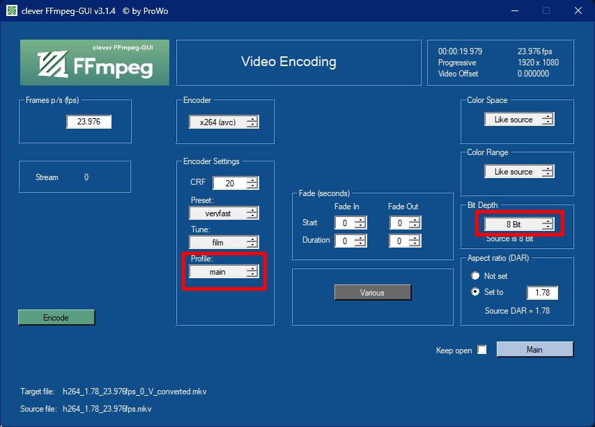

	The problem is the high profile.
 You shoud recode the video with the main profile and 8 bit.
 You can use clever Ffmpeg-GUI for that.Last edited by ProWo; 2nd Sep 2023 at 11:29.

	You should set profile main, not baseline.
 [Attachment 73597 - Click to enlarge]Last edited by ProWo; 2nd Sep 2023 at 11:32.

	Guys! I got a more clue about "bit depth" and add some parameters, I have this now :
 And now it works! All in one shot!Code:-c:v libx264 -preset veryfast -crf 28 -pix_fmt yuv420p -c:a copy -c:s srt  Too good! Too good!
